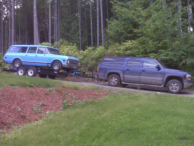

Thats sounds great I should try that (again)
I was just given another LWB and it is in great shape 95%rust free (can't find any but their must be 5% minimum right) but I have not decided yet what to do with it. First thoughts were to turn it into a roadster blazer, yes a blazer It is a C20 and a blazer needs C10 gear to look right but I do have a new set of Alcoa dually rims in the attic and a NOS set of 67 rear fenders so maybe a crew cab dually is back in order. Who knows but low buck or No buck is always a good place to start. Since Low Buck was finished we have put over 14K miles on it and right now my wife and son are at a car show with Low Buck and our 67 SS chevelle so it can't be all that bad. Good luck I will keep an eye on things.

Kevin,
I'm trying to figure out how you scored that rig for free? That is just crazy!

Originally Posted by mcbassin View Post
Kevin,
Ack,
Great score for $250!
Heck Low Buck was a freebie as well and came with a 67 LWB parts truck I had to take to get Low Buck
I think the trick is not having any extra room and not wanting any more is how they show up for free
