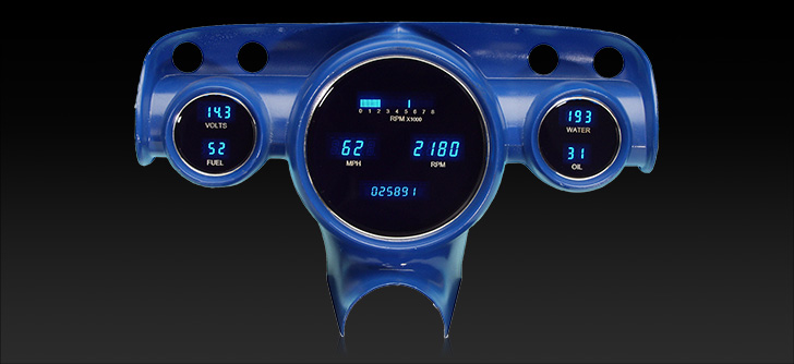

Next important decision, gauges. Few options I'm looking at.
1. Stewart Warner "wings"?
2. I was thinking of having Dakota Digital do custom gauges in my original gauge rings, I emailed them and they said the gauges would end up in a layout similar to this. I'm starting to think that would be mistake though...
3. Then there's this... I'm starting to like this a lot...
THoughts????

I'm not sure you would be happy with the second choice, they remind me of the late 80's early 90's GM digital clusters that were kind of cool at first but leave you wanting more. I like the SW gauges too because they look more period correct and have a nice style.
I've never used them but I really like the Dakota Digital VHX guages (third choice) because of all of the options you get with them. With the message center you get readouts like hour meter, 0-60 times, 1/4 mile timer/speed, high speed/RPM recall etc. Plus they have add on features that will display trans/oil temps, compass, inside/outside temp and more. It looks like it wouldn't take up alot of room behind the dash because you can mount the control box where its convenient and has just one cable running to the back of the cluster. Out of the three I'm sure this option would be the most expensive one but I think they offer a lifetime warranty.

Yeah, I think I will do the VHX kit, it looks pretty sweet and more importantly, fits in the spot in the dash! THe SW wings wouldn't all fit on the dash behind the steering wheel which would be a pain. THe VHX would all fit behind the wheel for one clean install...

Really nice work Christian! I used DD VHX in our 56 Chevy and have been very happy with them.

That's good to hear! I might order it next week or something... I'm gonna get closer to done this spring!
