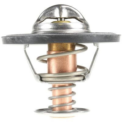

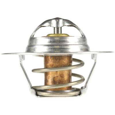

I was a wonderin' about that, plus the driver side cylinder head has the hole at the front of the block (not sure the diff) the passenger side (being a symetrical has it the back of the bloc (I would think the rear would be hotter, who knows) I know of some people who read from both holes and have two water temp gauges
anywho, AutoZone lists the OE thermostat at 195* F which is the one I am running, part #3009
http://contentinfo.autozonepro.com/z.../3009/image/4/
http://contentinfo.autozone.com/znet...009/3/image/4/
http://contentinfo.autozonepro.com/z...009/2/image/4/
http://contentinfo.autozonepro.com/z...009/4/image/4/
