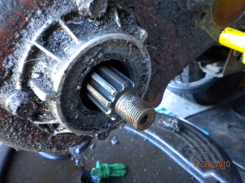

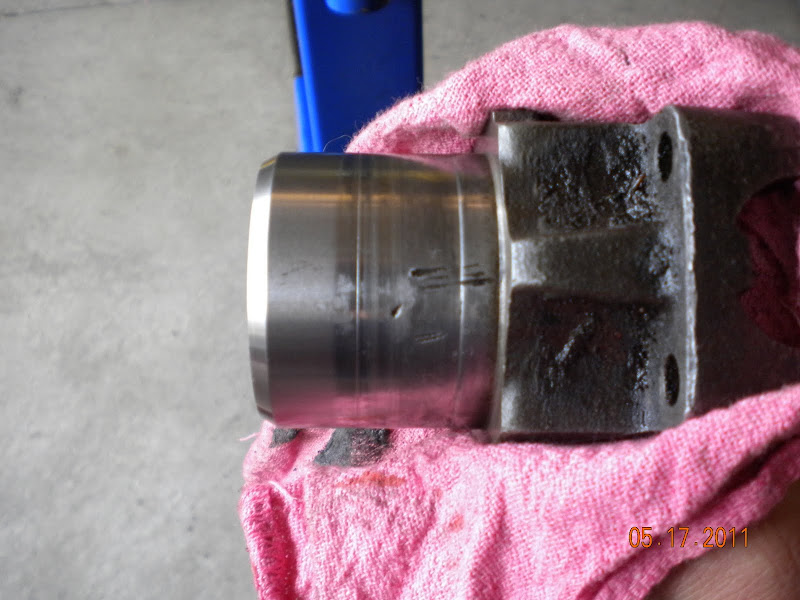

First I removed my rear output yoke. This is my home-made yoke holding fixture that has come in VERY handy over the years!
With the t-case in 4-hi I also removed the front yoke while holding the rear yoke.

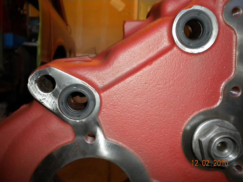

Next I removed the shift bar, marking what direction it came off. I like these shift shafts. The ones on my 79 K5 had a longer 2-4 shaft with a boot-shaped shift bar.
More digging. There are two detent ball assemblies that need to come out.

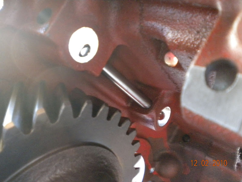

Next I removed the interlock pins. There is one in the front of the case and one in the rear of the case. I marked them so I would know where they came from.

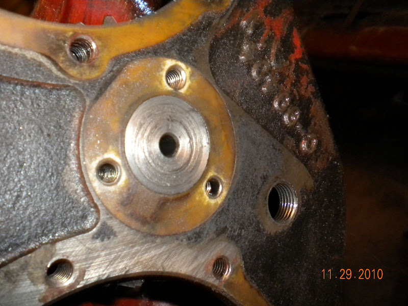

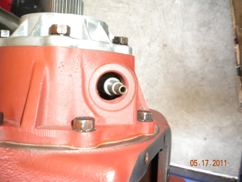

Next I removed the idler shaft cover on the rear of the case. This is NOT what it should look like! The idler shaft lock-nut had come loose and the shaft had been spinning against the cover. This could have caused sever damage if it had not been cought.
A few taps with a soft face hammer sends the shaft out the back. Be very careful not to damage the threads!

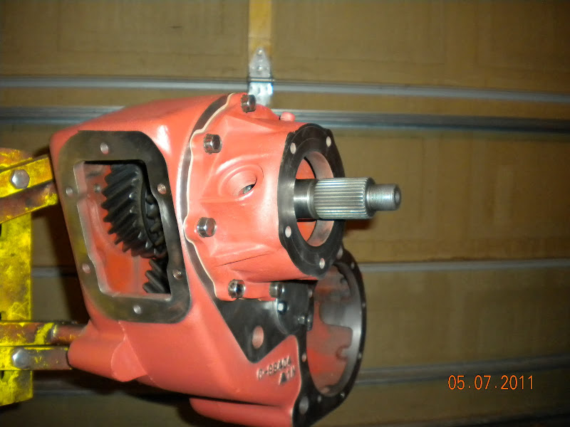

Dirty, nasty, bare case
Clean and painted case. I only used a primer because it matched to original color that I could find on the inside and outside of the case

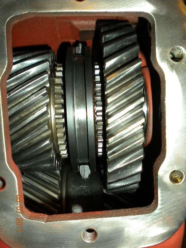

I installed the Hi-N-Lo shift fork assembly with the shift collar. This seemed to make it easy to keep the roll pin lined up with the hole in the case so it could be driven in.

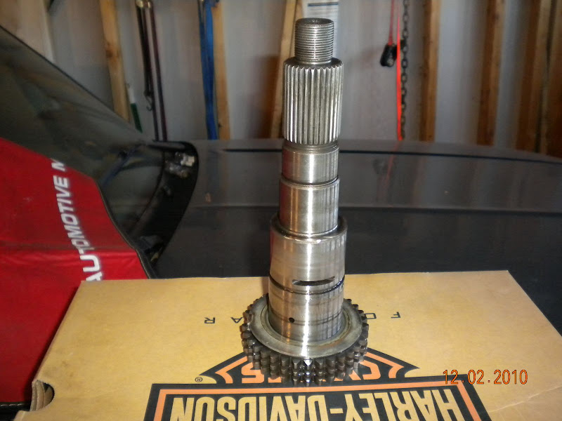

Thanks y5mgisi! Next I pulled apart the rear output assembly. This is the rear Low gear that is coming off the output shaft. First thing is pull the snap ring. You need a good large snap ring pliers on this one. Next is the index washer. Pay attention to that little pin sticking out of the shaft. The grove in the index washer needs to go over that.
Next pull the pin out of the shaft. This pin is real small and real important so don't loose it!
Next is the thrust washer. It has an indexing tab on it.
Next the low gear can be slid off. Have something that can catch all the rollers as they fall out. There is also a divider ring because there are two rows of rollers. the last thing to come off is another thrust bearing
This is the cleaned bare output shaft.

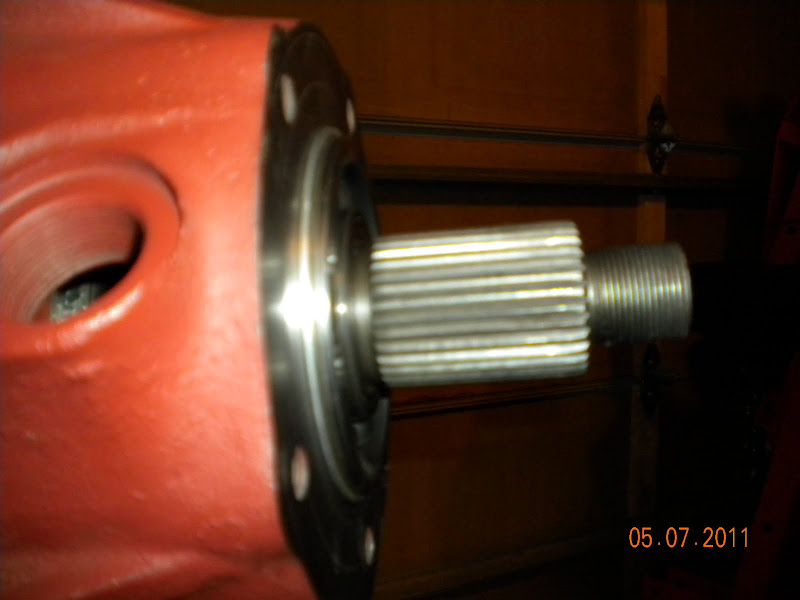

I'm showing this picture without the seal housing for reference. At this point you should be able to pull the shaft back against the bearing

For no reason, this time I set Low gear on the shaft, then installed the divider ring, then the second row of rollers.
Next the pin, then the indexing washer, then the snap ring
Next I installed the front output shaft in the case, feeding it through the shift collar and the High gear
Next I installed the thrust/slinger washer and the bearing with a perimeter snap ring. Sorry I forgot to take a picture of the bearing
For the front seal retainer my thumb is pointing to the oil passage that needs to line up with the notch in the gasket and the hole in the t-case. Here is the part I am not sure I did 100% right. The front seal has dual lips and the metal side is supposed to go on the inside. Well, both sides are metal, and there is a spring on both sides, so this is the way I installed it. Anyone wanna ensure this is correct?
I installed the seal housing with a new gasket, installed the bolts with sealant on the threads, and torqued the to 35lbft... I don't know why these are higher.
Next I used Petroleum Jelly to install the rear rollers
Then I installed the rear cover with a new gasket and sealant on the bolt threads. Torque is 30lbft

Next I installed the detent balls with the shift rails in Neutral, then the springs and then the caps. I don't have a torque spec for these
Then I installed the expansion plugs with a little sealant on them.
Next I installed the shift bar. Notice that on this type of linkage, the slotted hole goes to the 2-4 rail, and the holes are to the rear
Next I installed the linkage
Then the PTO cover with gasket and bolts. I don't have a torque spec, but the threads do need sealant
Then the speedo drive shaft and adapter. I don't have a torque for this

I am stopped here for a bit, this is a picture of my rear output yoke. I am going to try to clean off the teeth marks and speedi-sleeve it. This would be why I had a bad leak at the rear output.
If all your yokes are good to go, The torque spec that I found is 150lbft for rear. The front of this case is 10 spine. I don't have a torque spec. 30 and 32 spline front output torque is 150lbft. I will be using new nuts on both and speedi-sleeves on both. Once I have the sleeves I will cover the repair here.
